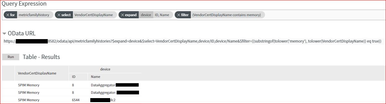

The recommended method to generate lists of devices using target Vendor Certifications (VCs) is the Data Aggregator OData OpenAPI queries.
Using the Query Builder this is a sample basic query.
The VendorCertDisplayName value is the VC name seen in the Portal UI. The one in the sample would return any VC with the word 'memory' in it.
