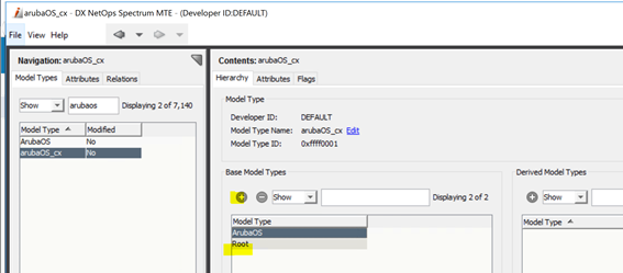

add the model type ArubaOS_CX from based model type arubaOS and the root model.
Make it instantiable.
Change the  Disposable_Precedence attribute to 12.
change the sysOIDverify list attribute to add only the oids the new model type.
save and exit MTE.
That is all you need to do.  Any new device with the correct oid will be modeled as ArubaOX_CX.
