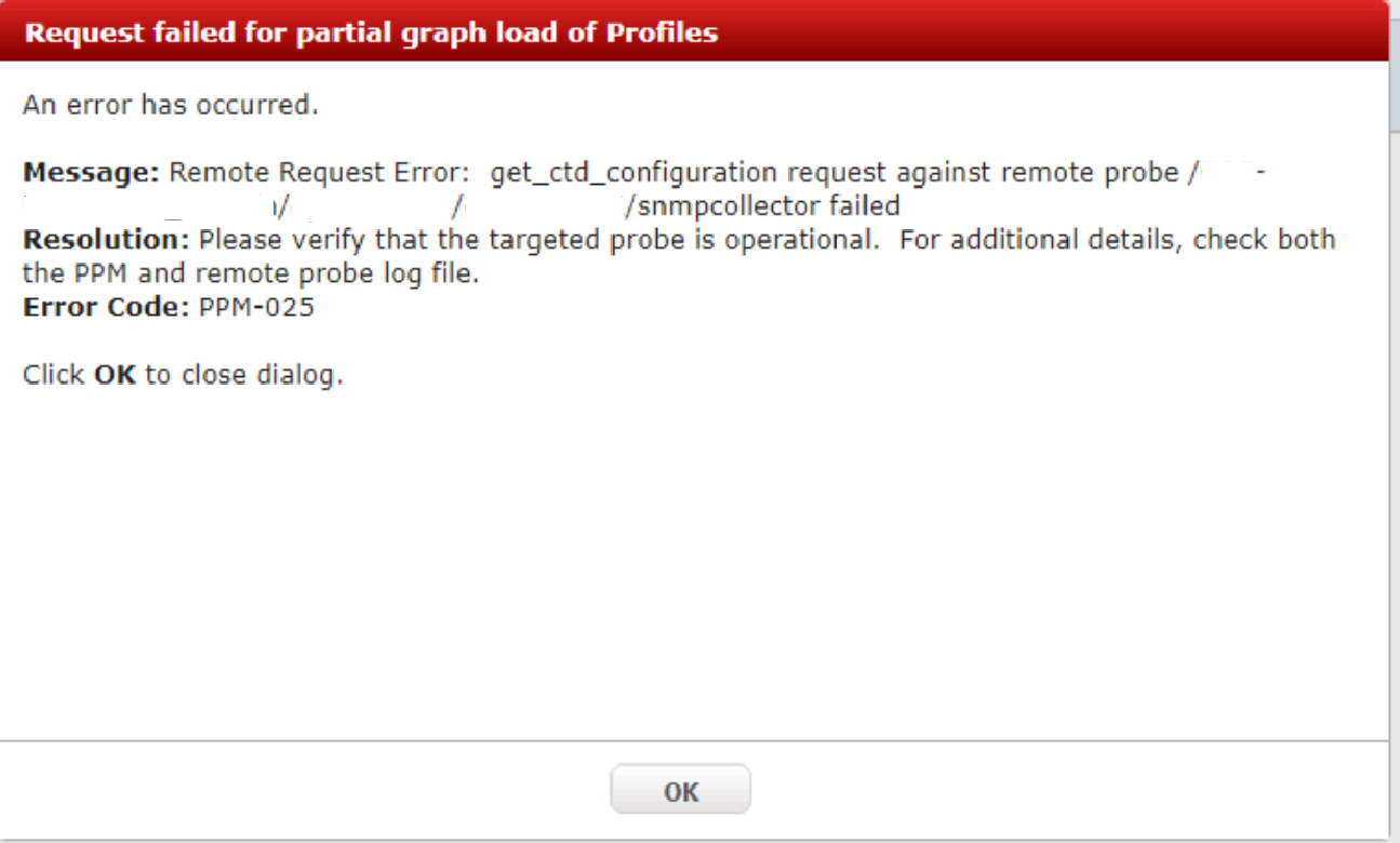

We can't open the snmpcollector probe from Admin Console. The probe remains loading for a few minutes then we get the error below:
Configuration was unable to be retrieved.
Message: Remote Request Error: get_ctd_configuration request against remote probe /snmpcollector failed
Resolution: Please verify that the targeted probe is operational. For additional details, check both the PPM and remote probe log file.
Error Code: PPM-025
