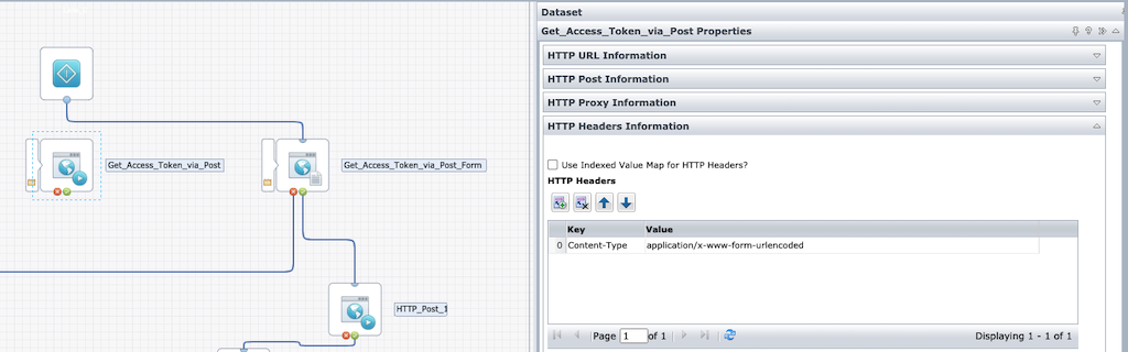

It is possible to use the HTTP Post operator. However, it involves a little more effort than using the HTTP Post Form. To use the HTTP Post operator you will need to:
  1. Group together all of the form's key/values and separate them using an ampersand character and add this to the HTTP Post Information -> Content input field - as seen in figure 2 below.
  2. Add the "Content-Type = application/x-www-form-urlencoded" HTTP Headers Information -> HTTP Headers table - as seen in figure 3 below.
Figure 2
Figure 3
Once your operator is working successfully, one way to use the access_token returned in other operators is to setup the HTTP Post Form's post-execution script to capture the result and add it to a Process variable. For example:
var response=Process[OpName].HTTPResponseContent;
var token = JSON.parse(response);
Process.access_token=token.access_token;
