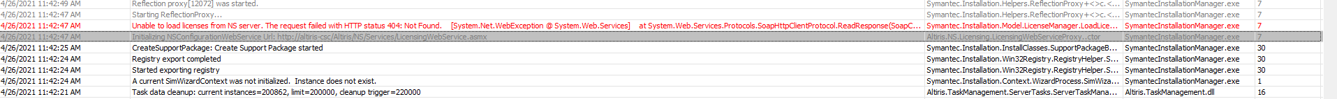

You can enable "Trace" and "Verbose" options in the Altiris Log Viewer by selecting the following:
You should see the actual page that is being called before the error. In this example:
Initializing NSConfigurationWebService Url: http://altiris-csc/Altiris/NS/Services/LicensingWebService.asmx

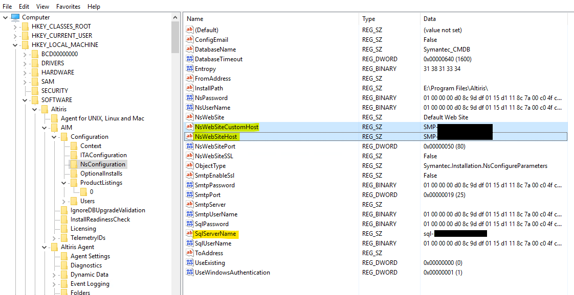

  3. Go to HKLM>Software>Altiris>AIM>Configuration>NsConfiguration registry and under "NsWebSiteHost" and "NsWebSiteSSL" regkeys, add the full FQDN to the server (something like Altiris-CSC.domain.com).
    You may also do the same add the FQDN to this regkey if your the SQL server is on-box: "SqlServerName"
