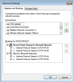

The non standard 1394 adapter for example is bound first in the operating systems binding order
cause issues with cam and changing binding order will resolve the issue.
Check the network binding order for all Network Interface Cards (NIC):
Make sure the Functional NICs are at the top of the list and not the '1394 adapter'.
If the Firewire adapter (1394 adapter) listed above any of the functional network adapters, it can break CAM/PMUX functionality.
If you find this situation, click on the 1394 item to highlight it and then use the 'down arrow' at right to lower it to the bottom of the list.
Now click OK and you are done. Run 'camclose & cam start -c' to restart CAM. CAM will now start and the Port
Multiplexor (CSAMPMUX.EXE) will work properly without a reboot. (Start CAF now and it should work as expected)
