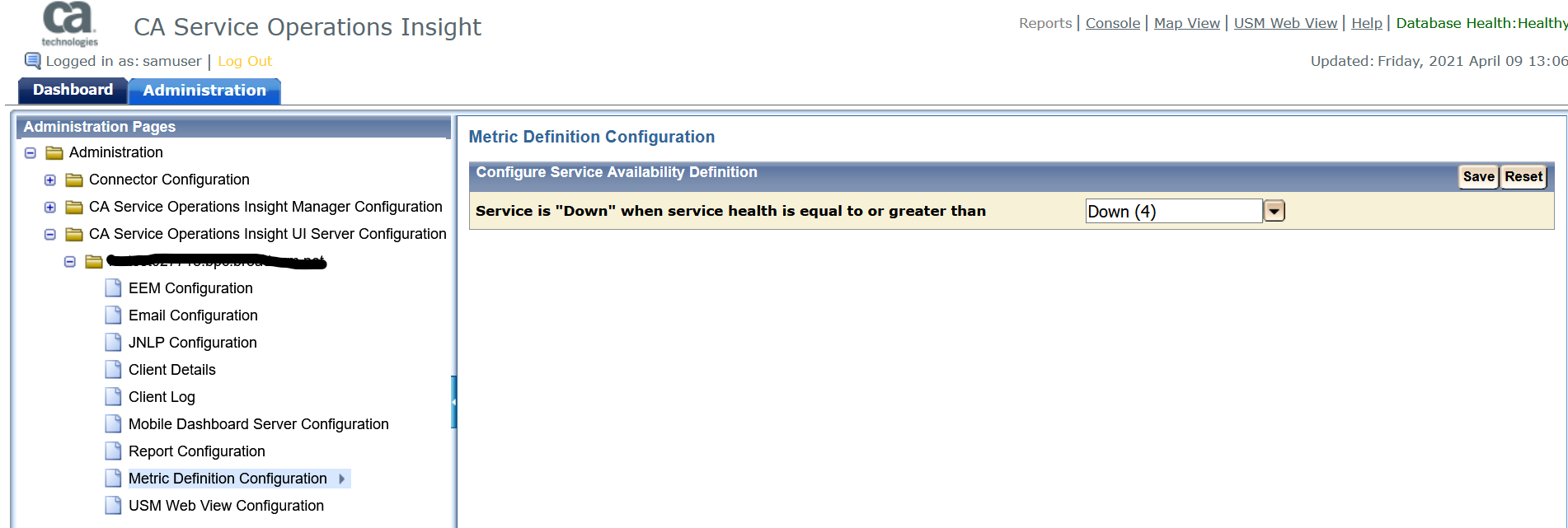

The other option is change Metric Definition configuration as shown below:-
