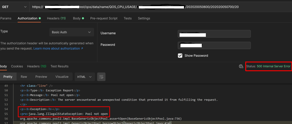

After upgrading to UIM 20.3.3 REST API calls  are failing with HTTP 500 error. This is the exception as reported in the browser when attempting an API call:
java.lang.IllegalStateException: Pool not open
org.apache.commons.pool2.impl.BaseGenericObjectPool.assertOpen(BaseGenericObjectPool.java:736)
The failure happens with both uimapi and webservices_rest deployed to the OC robot, and the uimapi log has the exact same info the browser shows.

If using webservices_rest with a GET call direct in a URL without a REST client it might just return a http 404 error.
When using a REST client it will show up in the return data.
