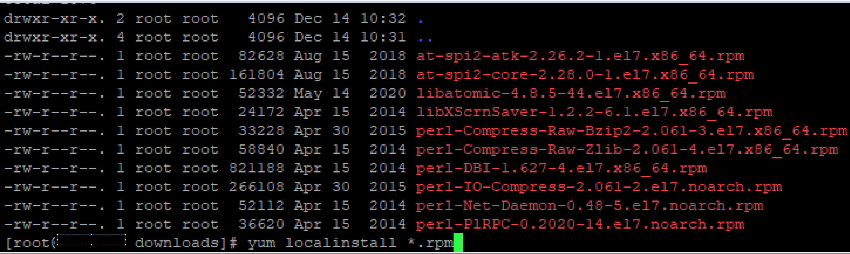

METHOD 2:
Download the rpms dependencies locally and install from disk.

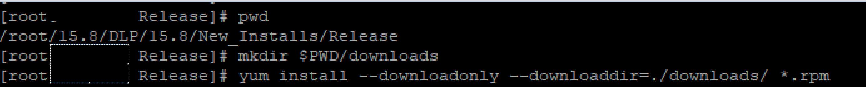

NOTE: you need to create the directory where the dependency rpms are downloaded to. /path/to/dlp/download is an example path and that should be changed to the path that is reachable on the system
  1. extract the dlp rpms
  2. mkdir -p /path/to/dlp/rpms/download
  3. yum install --downloadonly --downloaddir=/path/to/dlp/rpms/download *.rpm
  4. You should see the following message:
  5. cd /path/to/dlp/rpms/download
  6. yum localinstall *.rpm
NOTE: change /path/to/dlp/rpms to where you extracted the DLP rpms.

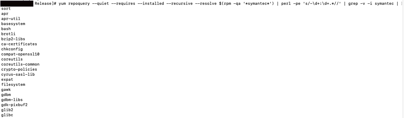

Method 3
This process requires perl to be installed on a rhel server. Also the returned output lists all dependencies that are installed. Below is an explanation of each switch:--installed
--installed
Restrict query ONLY to installed pkgs - disables all repos
              and only acts on rpmdb.
--recursive
              When used with --whatrequires, and --requires --resolve,
              query packages recursively.
--resolve
              When used with --requires/--weak-requires/etc, resolve
              capabilities to originating packages.
1. cd to the extracted RPM install files
2. run the following command:
yum repoquery --quiet --requires --installed --recursive --resolve $(ls *.rpm) | sed 's/-[0-9]\+:[0-9]\+.*//' | grep -v -i symantec | uniq|  sort
To find out what dependencies you are missing or not installed remove the --installed switch:
yum repoquery --quiet --requires --recursive --resolve $(ls *.rpm) | sed 's/-[0-9]\+:[0-9]\+.*//'  | grep -v -i symantec | uniq | sort

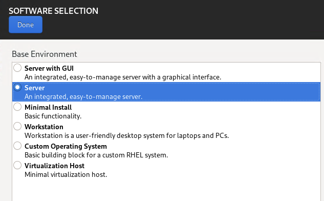

When install RHEL and choosing the Server template in the Software Selection>Base Environment:
The below versions and the dependencies are listed below:
