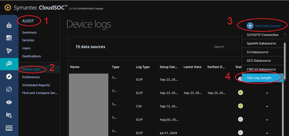

3- Test the format using the "Test Log Sample"
