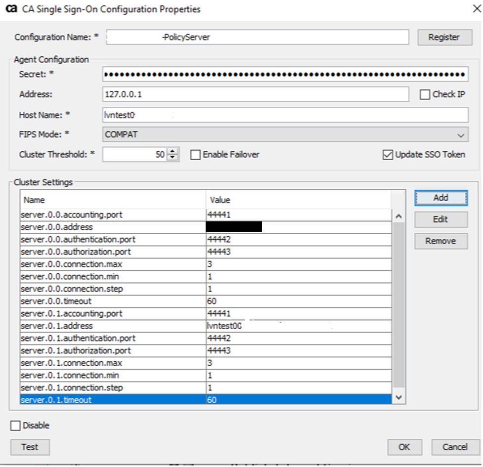

Before the re-Registration
The information and values about :
Address
Authentication.port
Authorization.port
connection.max
connection.min
connection.step
timeout
are present on the screen above.

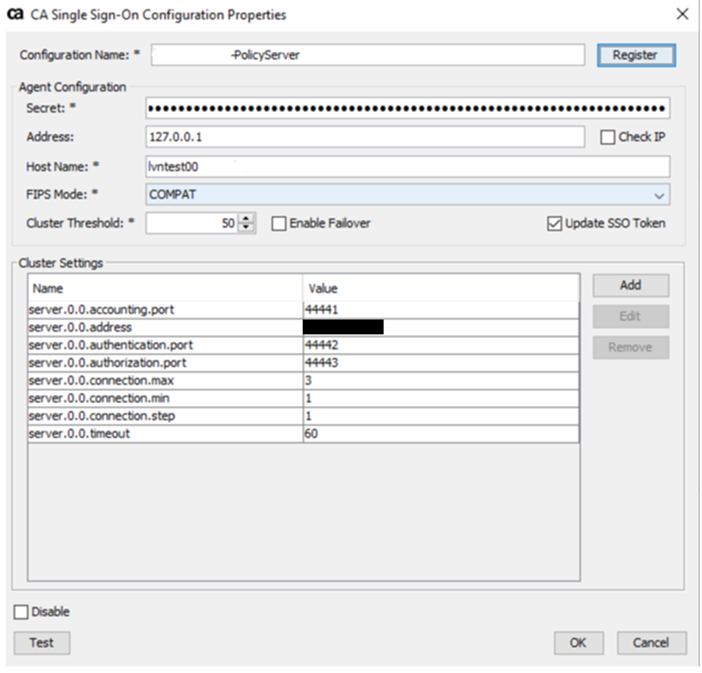

After re-Registration
Note : The information about :
Address
Authentication.port
Authorization.port
connection.max
connection.min
connection.step
timeout
are missed on the screen above. To recover that required info, apply the workaround suggested as a solution.
