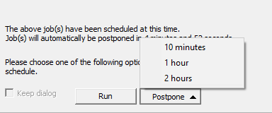

When a SD Job is configured with User Prompt Timeout, the SD JobCheck dialog box appears with a Postpone listbox containing different values for postpone :
Is it possible to configure the list of Postpone in the listbox ?
Client Automation - All versions.
Unfortunately values in Postpone listbox could not be changed.
It is always these values :
10 minutes
1 hour
2 hours
6 hours
12 hours

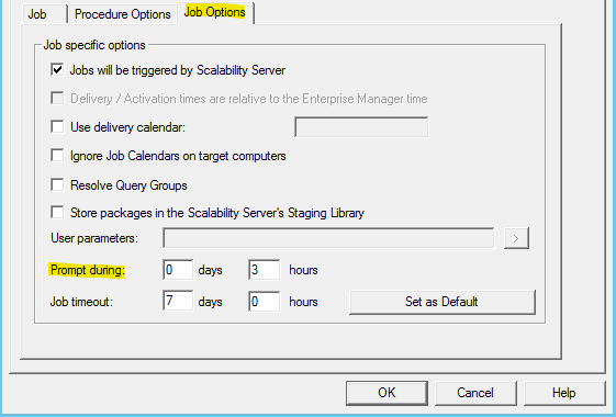

But it is possible to set a total delay for "Prompt User" in SD Job properties in tab Job Options in Prompt During
Default value is 1 Day
For example if 3 hours is put (Remark : put 0 in days field because if this field is let empty it is automatically set to 1), Postpone listbox will contain only possible values for postpone (so lower than "Prompt during" and lower than difference between current time and final time of prompt).
There is no maximal number of postpone action.
It is "Prompt during" value which determine the number of possible postpones.
More than 10 postpones could be made if "Prompt during" allows it.
