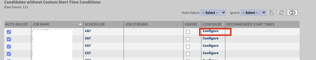

Then go to the AAI web page http://<ServerName>:8080/aai/web/v1/ click on System Tools->Custom Condition Admin and you should start to see a list of candidates, in the "Candidates without Custom Start Time Conditions" window.
You can select Configure next to a job/dataset to manually set the start time.

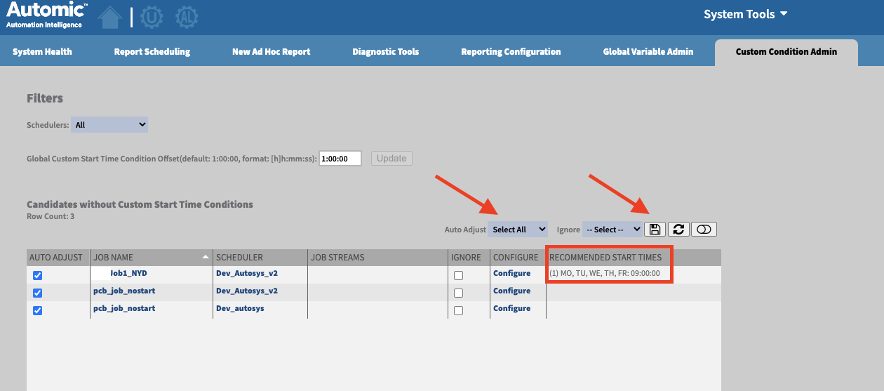

AAI will try to calculate a Recommended Start Time for your datasets or jobs that show up in this window.

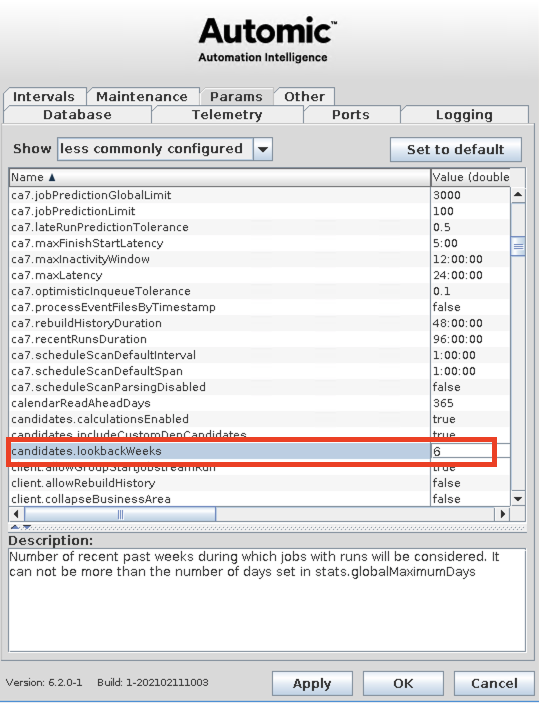

By default it tried to calculate this by looking back at 12 weeks of data.  If you just added the scheduler, it may take several weeks to start seeing Recommended Start Times.
You can adjust this by modifying the candidate.lookbackWeeks from the configuration tool.
The longer the lookbackWeeks parameter is set the more accurate these will be, however if you have just added a scheduler and want to start setting some of these automatically you can temporarily set this to 1 or 2 weeks.
After modifying the setting, rerun the Statistics Generator, and refresh the Custom Conditions Admin page to see the Recommended Start times.
You can then select the "Select all" option from the drop down list next to "Auto Adjust" and click the save icon, which will set the custom start times for any job with a Recommended Start Time.
Once that process completes you will see the job is moved to the bottom window:
