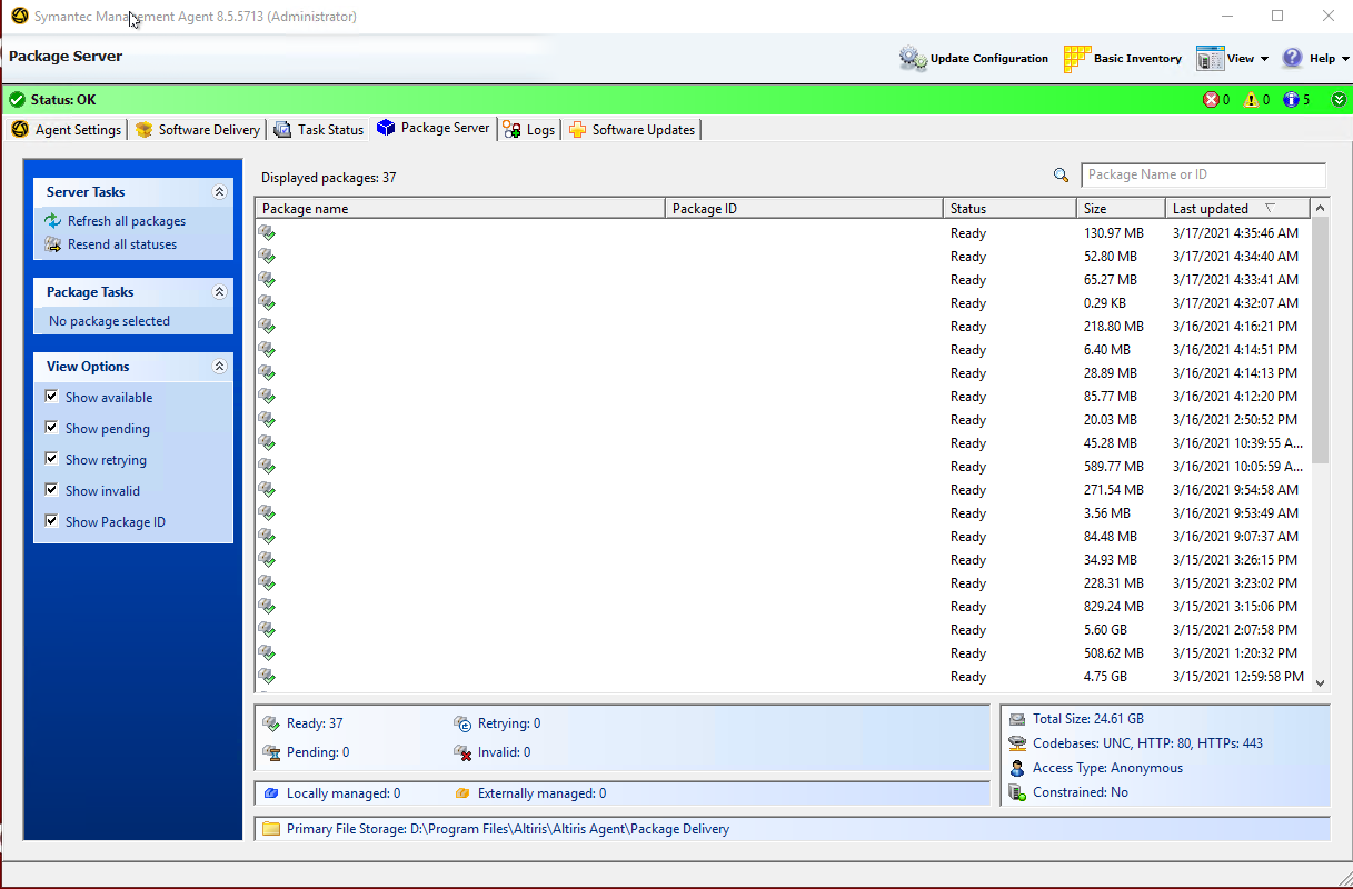

Package Server has less Ready packages than the Notification Server is showing, and the Notification Server Console is showing many Download Pending Packages.  In our example the Symantec Management Platform showed 550+ packages, and the Package Server had 37 Ready and 0 Pending packages.  It seems that at some point the Package Server lost all of its packages and started redownloading them.
Agent UI shows:

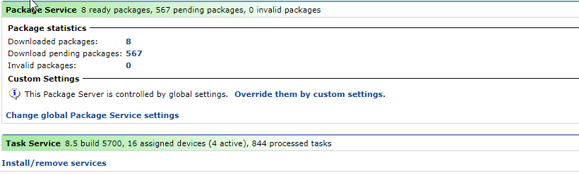

This is an earlier screenshot of the SMP when 8 packages were ready.  This number slowly increased but then eventually stopped increasing once it got to 37.
