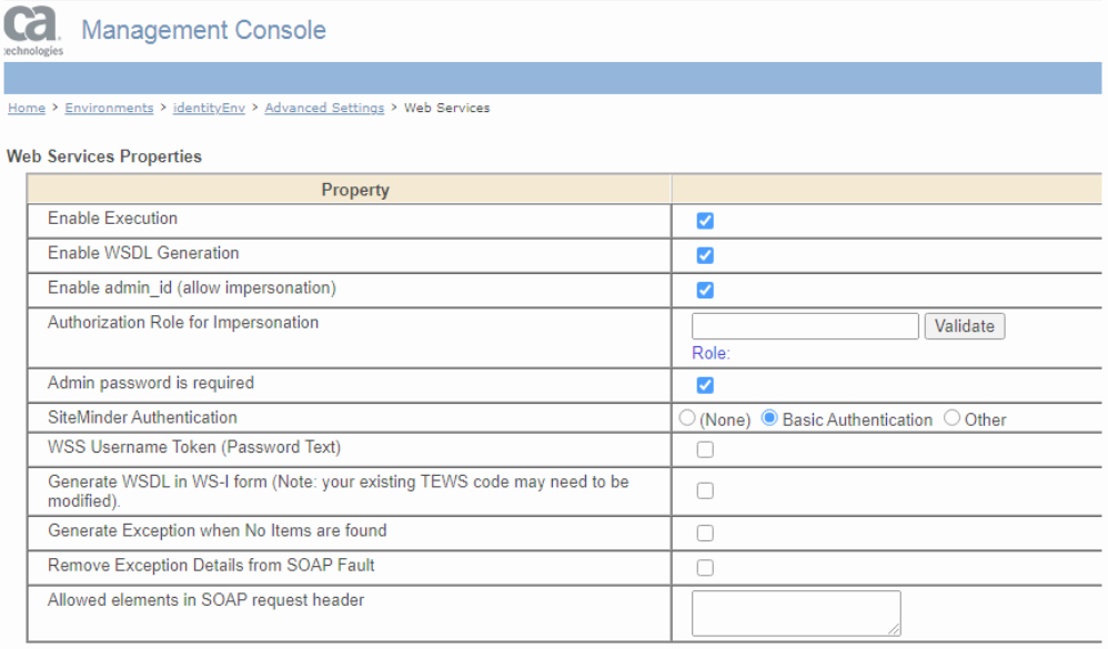

I have selected "Enable Execution", "Enable WSDL Generation", "Enable admin_id (allow impersonation)", "Admin password is required" for "Web Services" for the IM environment. "SiteMinder Authentication" is set to "Basic Authentication", this means TEWS is protected by SiteMinder as well.

As you have enabled the "Enable admin_id (allow impersonation)" the task will run under the context of specified admin_id user within SOAP XML. SiteMinder will only do Authentication. You can use different user credentials in the SOAP Authorization header to be authenticated with SiteMinder, however admin_id which is specified within the SOAP XML will determine what user runs the task in IM.

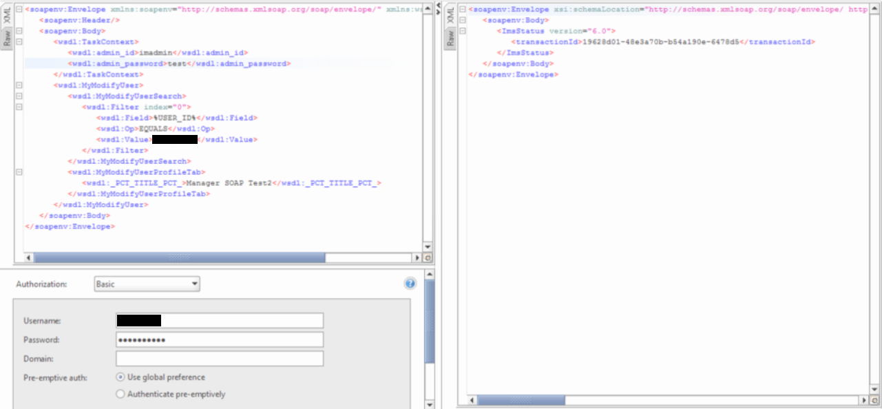

So this means, if a user with less privilege is authenticated by SiteMinder, and more privilege user is specified as admin_id within the SOAP XML request then IM will run the task under the more privilege user.
Below I have specified admin_id as imadmin within SOAP XML while the credentials in Authorization header is my sample user which has been blocked out. A normal user who doesn't have privilege to run the "My Modify User" task. The SOAP call was successful.
