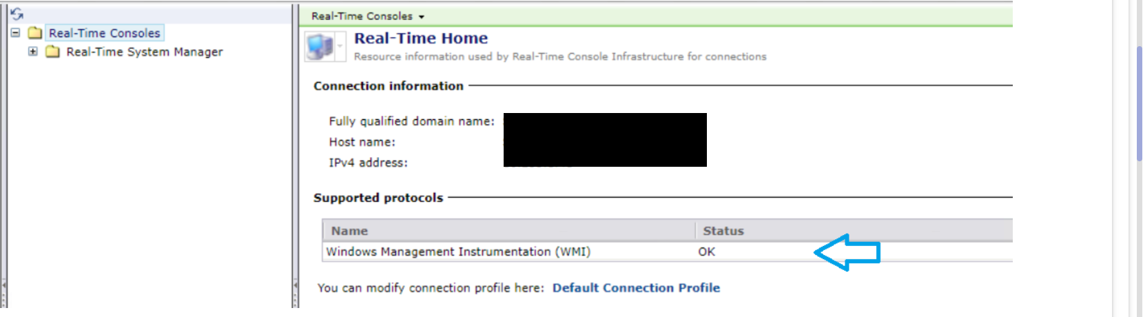

Find the computer in question under Manage > Computers and right-click it.  Choose Resource Manager. With the resource manager opened, click on View > Real Time.  This will take a minute to open and you should see a message stating a status of OK for WMI as seen in the screenshot below:

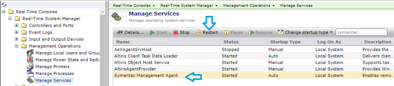

Now navigate to Real-Time System Manager > Management Operations > Manage Services.  Highlight the Symantec Management Agent Service and choose Restart as shown here:
