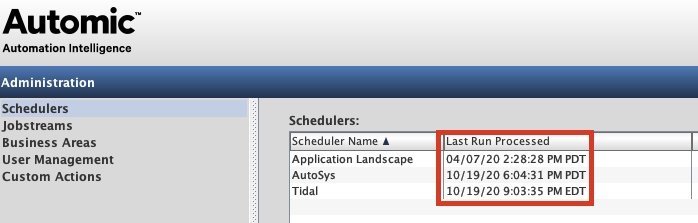

The jaws.log shows repetitive messages about a long running query against the Tidal database like below:
100.0%: 1x (avg. time: 1:00.009) query: from TidalDbMessageLog where jobRunId in (:jobRunIds) order by creationDate, id
Release : 6.0.1
Component : AUTOMIC AUTOMATION INTELLIGENCE ENGINE
This likely indicates there are some performance issues on the Tidal Database server, or other database related issues on the Tidaly Database side.
To work around this you can restart the AAI service and all the service to come back up, and monitor the jaws.log for reoccurrence of this long running query.
You can verify the system is catching up by looking at the "Last Run Processed" time to see if it is updating over time on the Admin->Schedulers window of the AAI Client.
