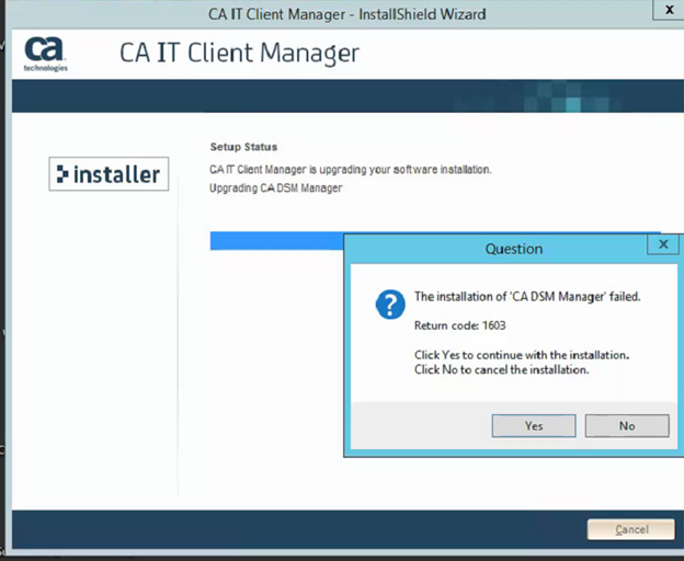

The Client Automation Installation/Upgrade is failing while installing the MDB with the below pop up:

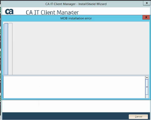

Then it finally fails with below error:
We see the follow error in the install_mdb.log:

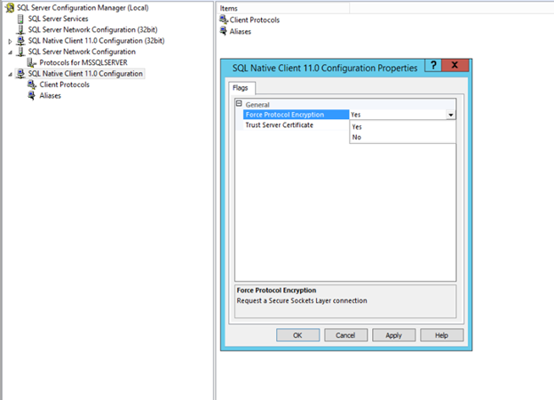

The issue occurs if you have the SSL encryption enabled in the SQL Server Configuration Manager.
Open the SQL Server Configuration Manager and make sure that ‘Force Protocol Encryption is set to ‘No’ under the SQL Native Client 11.0 configuration and SQL Native Client 11.0 configuration (32bit) properties.
Recycle the SQL Server Service and re-run the installation/upgrade.
