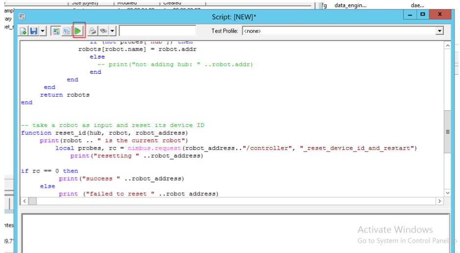

1.Open Scripts Menu:
Open the NAS GUI and navigate to Auto-Operator and select Scripts.
2.Create a New Script:
Create a new script and paste one of the code blocks below.
3.Configure Target:
Edit the first line of the script to define your specific domain or hub address.
4.Execute:
Click the green Play button. The script will print error-checking information and a list of results upon completion.
