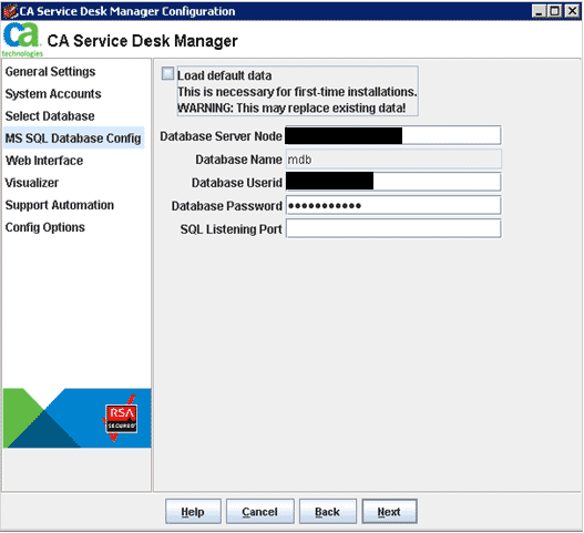

When running the CA Service Desk Manager Configuration tool, the "MS SQL Database Config" step contains a checkbox named "Load default Data". The additional information on the form advises: "This is necessary for first-time installations. WARNING: This may replace existing data!". See Figure 1 below.

Figure 1. The "MS SQL Database Config" step in which the "Load default data" option is available.
