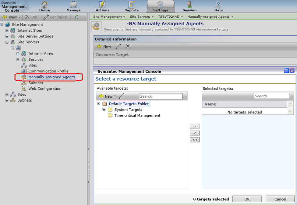

However, you have the ability to assign the client manually to the exact Site Server (Task Server, etc.) depending on your needs as shown here:
NOTE: In this case, only this Task Server is available to be selected by the client machine. If the Task Server is switched off then no tasks will be processed by the selected client machine.
