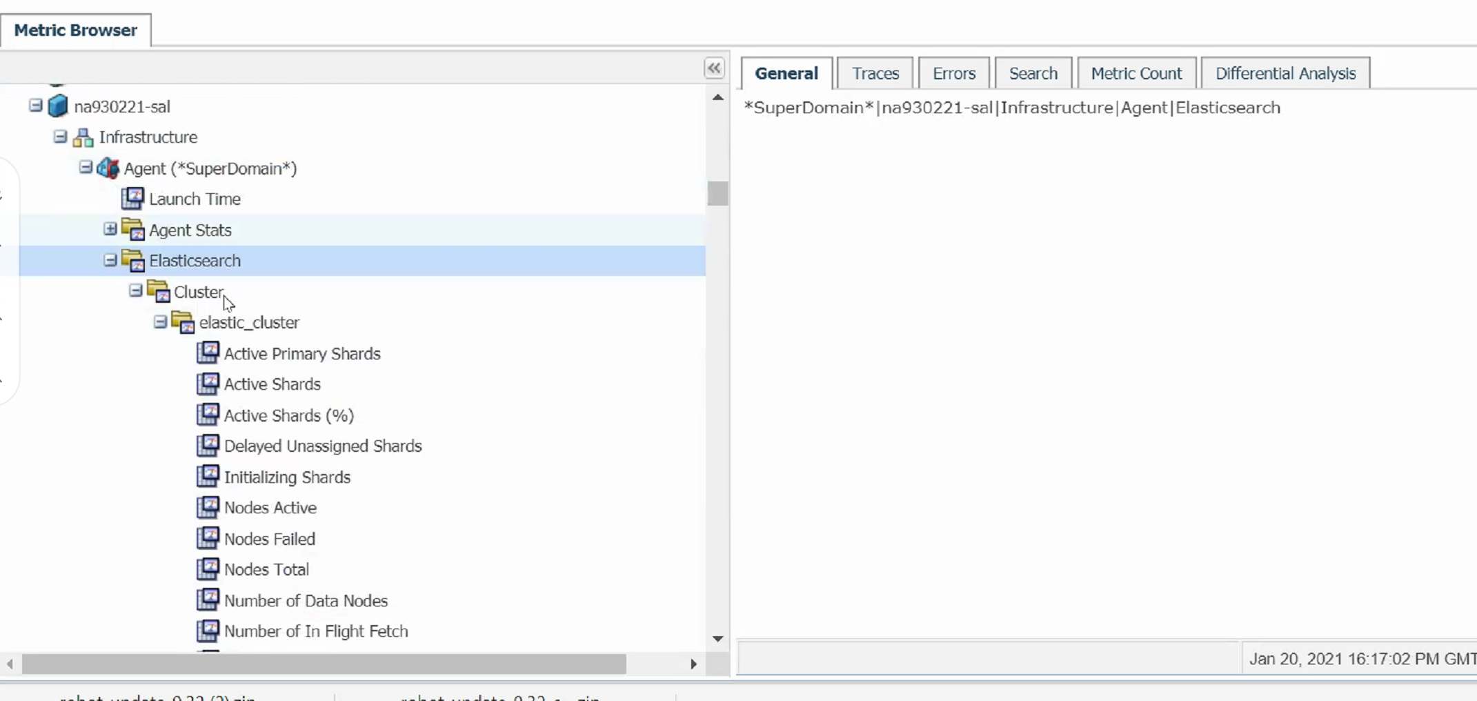

When using Elastic Search agent, it throws a lot of metrics, how can we filter it:
