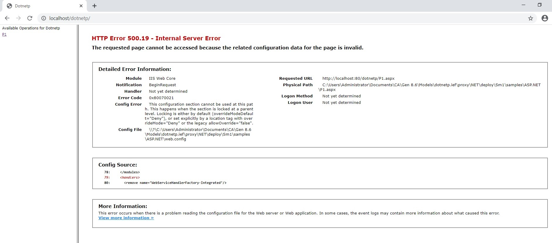

On browse http://localhost/dotnetp receive error:
HTTP Error 500.19 - Internal Server Error
The requested page cannot be accessed because the related configuration data for the page is invalid.
Release : 8.62
Component : Gen Run Time, Proxies
1. Under Server Manager/ Server Roles for “Web Server (IIS)” enable all options for “Application Development” and restart IIS:
2. A proxy page reload will then show the "operation" link on the left but similar "HTTP Error 500.19 - Internal Server Error" error still appears on the main part of the page:
3. Under IIS Manager “Default Web Site” Configuration Editor unlock the section "system.webServer/handlers" for "ApplicationHost.Config" and restart IIS:
BEFORE:
AFTER:
4. A proxy page reload then shows no more errors.
