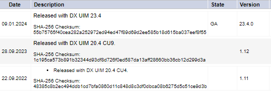

Locate the following package in your UIM Archive:
uim_cabi_availability_report_pack
(the version of the package can change based on your DX UIM Version)
Eg:

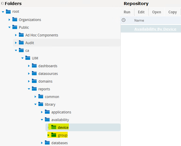

Deploy this onto the robot where the CABI probe is.
After about a minute reload the page and you should see the reports under Repository-> public/ca/reports/library/availability:
