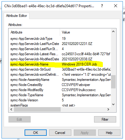

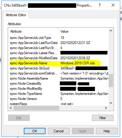

    Double-click on the query results (in the middle panel) to bring up the query details and scroll down until you see the 'symc-AppServerJob-Name' Attribute, and that will show the name of the CCS job in the 'Value' column.
    Log in to the CCS console as the user (must have CCS administrator role or equivalent) you would like to own that scheduled job, and edit that job (you don't have to change anything) but save that job so that the user is updated in the database.  Now that scheduled job will run as the user.
