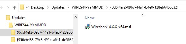

Example structure created after downloading a Wireshark bulletin named Wireshark-YYMMDD:
After completing these steps, the required staging file structure will exist and can be imported into Patch Management in Part 2.
