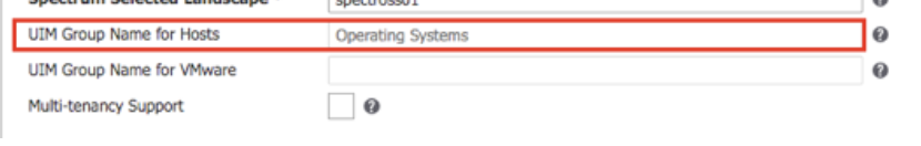

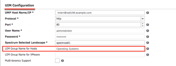

1. A UIM Group Name was specified for the Host Sync and the Host(s) in question are not a part of this group
