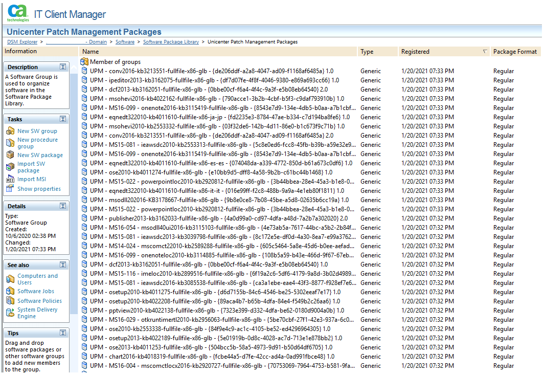

1- When a IntelliRollup Patch is accepted in Patch Manager, all single patches in the Rollup are accepted, downloaded and registered as a SD package in ITCM.
Example:
"CA - Office 32Bit - Security IntelliRollup v2101.00" was accepted and a lot of SD packages were created for all patches included in this Rollup :
Also a special Software Group of type “Patch Rollup” is created under All Patch Rollups
It contains all SD Packages for the patches included in the Rollup and the SD package “Security IntelliRollup”

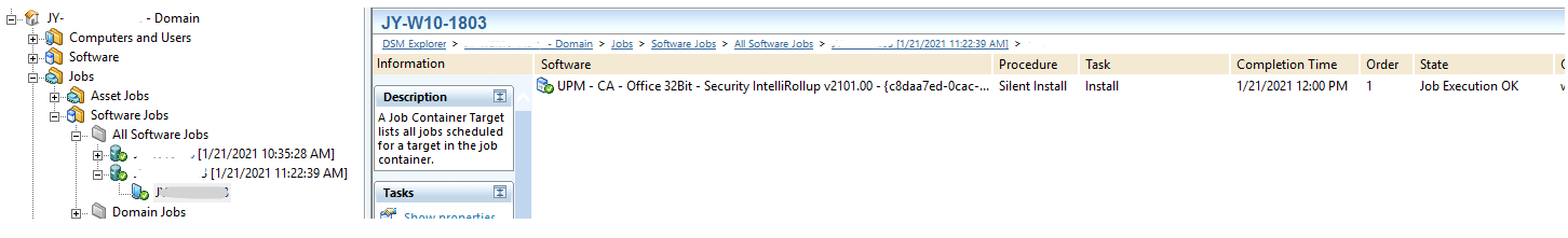

8- After all these steps the status of SD Job should be set to OK in DSM GUI
9- In "Installed Packages" folder of the machine we could see all SD packages installed by the Rollup
And also SD Packages for patches which have been detected as "already installed" but are not yet present in "Installed Packages" folder are added.
