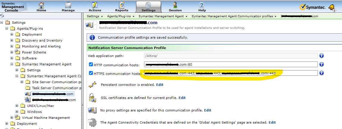

  1. The agent can switch from HTTP to HTTPS in case CEM policy is enabled or a persistent connection is enabled. Both these features require an agent to work over HTTPS so it switches to HTTPS. That's by design.
  2. The Agent Communication Profile hosts below - host with 4726 port should not be added manually, CEM connection uses settings from CEM policy, 4726 port is not needed in the profile and can only harm because an agent may try connecting to port 4726 in case it could not connect to port 443. Please remove 4726 from the profile.
    1. <servername>.example.com:80;altrsns-01:80
    2. <servername>.example.com:443;<servername>:443;<servername>.example:4726;<servername>-01:4726

The above message says that the Agent Communication Profile contains two hosts, one with SSL port and the second is with CEM port.
That 4726 record forces an agent to connect to the server via port 4726 directly rather than port 443.
There should be no CEM ports in the Agent Communication Profile, the alternative hostnames are supposed to be there:
1. Under SMP Console > Settings > Agents/Plug-ins > Symantec Management Agent > Symantec Management Agent Communication profiles, Remove any reference for the CEM port used (by default port 4726). Save changes.

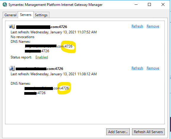

The Servers list in an Internet Gateway is the one that tells the agents to use port 4726 for any SMP server listed when they need to connect.
Note: If there is a Site Server that is acting as an Internet Site Server, then this port 4726 will be added to its Site Server Communication Profile.
