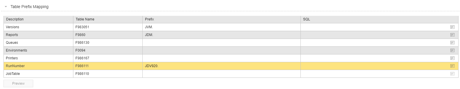

The RunNumber SQL statement does not take the prefix defined on the JDE agent in client 0 in account:
select CAST(jcjobnbr AS VARCHAR(25)) as runID from F986111 where upper(rtrim(jcexehost))=?
The SQL statement should be:
select CAST(jcjobnbr AS VARCHAR(25)) as runID from JDV920.F986111 where upper(rtrim(jcexehost))=?
Click on the SQL statement tab and add the prefix to the SQL statement.
