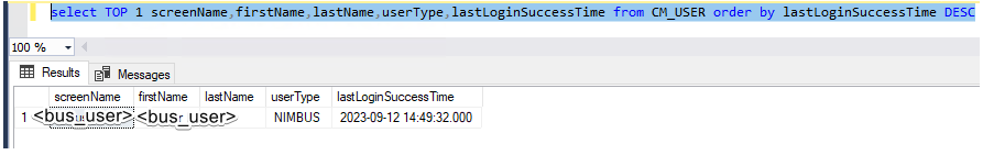

To audit what is the last user that has logged into OC:
select TOP 1 screenName,firstName,lastName,userType,lastLoginSuccessTime from CM_USER order by lastLoginSuccessTime DESC
