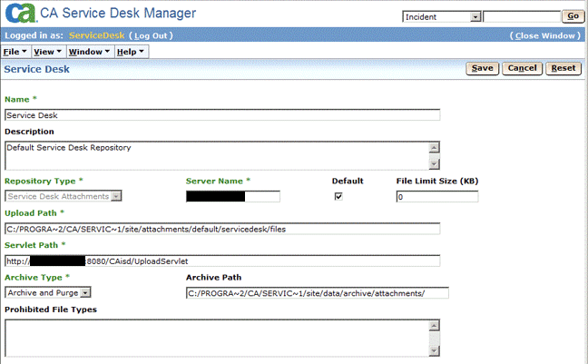

(1) Login to CA SDM and click on the "Administration" tab.
(2) Navigate to "Attachments Library" > "Repositories" as shown below:
(3) Right click on the "Service Desk" repository and click "edit".
(4) Set the Archive Type to "Archive and Purge" and the Archive Path to a directory where you want to store the archive output as shown below:
(5) Click the "Save" button.
Re-test your archive/purge rule - you should notice that now the physical attachment files will be included in the archive output in the directory specified
