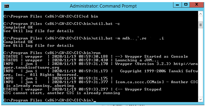

But when running the job manually, the following message can be seen:
Which is also seen on Wrapper log:
STATUS | wrapper  | 2020/11/24 09:44:28 | Launching a JVM...
INFO   | jvm 1    | 2020/11/24 09:44:29 | Wrapper (Version 3.2.3) http://wrapper.tanukisoftware.org
INFO   | jvm 1    | 2020/11/24 09:44:29 |   Copyright 1999-2006 Tanuki Software, Inc.  All Rights Reserved.
INFO   | jvm 1    | 2020/11/24 09:44:29 | [com.ca.sccc.CCMain] - Another CIC is already running, aborting
STATUS | wrapper  | 2020/11/24 09:44:31 | <-- Wrapper Stopped
That message means that CIC is already running by a previous execution but it never ended successfully.
