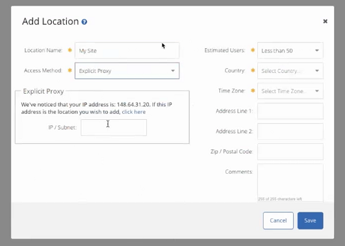

Static location:
Suggested setting: Do not set a static location unless you are proxy forwarding from your local proxy.
This is for proxy forwarding used to proxy forward from the on-prem proxy.
