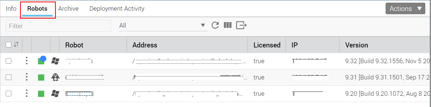

2) Click on Robots then select the appropriate robot (by clicking on the robot name) where oracle probe is deployed:

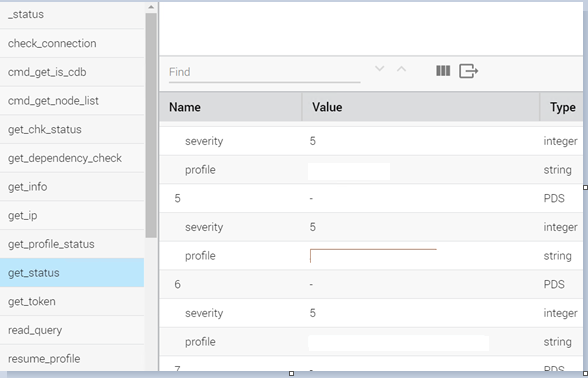

5. Click on "get_status" then click on the green triangle:
6. You would see the profile details:
7. Similarly, you could view different information selecting the different "get_" option:
