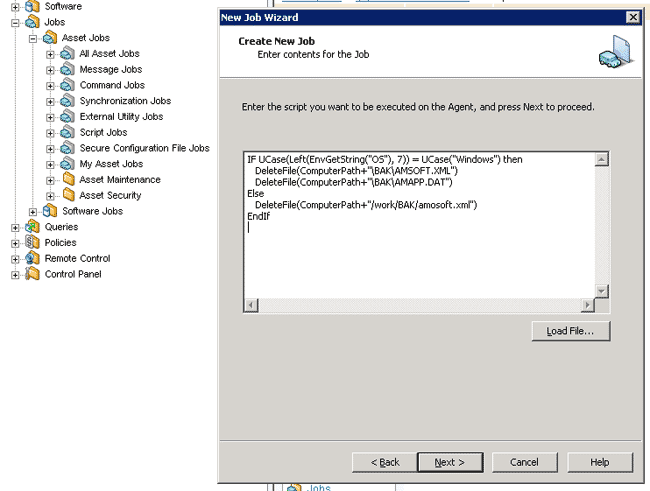

Solution 3:
Another solution is to delete the software inventory files located in BAK directory on agent machines. So no delta will be found and a full software inventory file will be sent to the Scalability Server.
It is possible to force the sending of a FULL software inventory by deleting the software inventory files located in BAK directory on agent machines. This could be done with a Asset job Script.
  1. In DSM Explorer go to Jobs/Asset Jobs.
    Right Click on "My Asset Jobs" and select New in popup menu.
    The "New Job Wizard" dialog Box appears. Select "Script" in Job Type listbox
  2. Click Next. Give a name to the job. In this example - "Synchronize Software Inventory".
    Click NEXT
    Enter following script :
    IF UCase(Left(EnvGetString("OS"), 7)) = UCase("Windows") then
     DeleteFile(ComputerPath+"\BAK\AMSOFT.XML")
     DeleteFile(ComputerPath+"\BAK\AMAPP.DAT")
    Else
     DeleteFile(ComputerPath+"/work/BAK/amosoft.xml")
    EndIf
  3. Click Next. Click on "Set Scheduling" button.
    In Tab Scheduling, select "Run Only Once".
    In Tab Miscellaneous, check "This job is allowed to run unattended"
    Click OK and Finish.
  4. Drag & Drop this job to "All Computers" group or the computer group with machines you want to re-synchronize.
