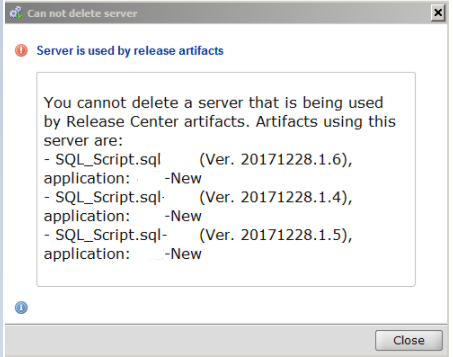

We have encountered a problem when we attempt to delete or remove an old agents which no longer exist.  We are seeing an error message "You cannot delete a server that is being used by Release Center artifacts."
Release : 6.6, 6.7, 6.8
Component : CA RELEASE AUTOMATION RELEASE OPERATIONS CENTER
There are two possible causes for this error:
1. The agent in question currently belongs to an agent group.
2. A problem with the database is preventing the removal. (This is an environment-specific problem in which somehow the data within the database was improperly altered/corrupted/etc.)
