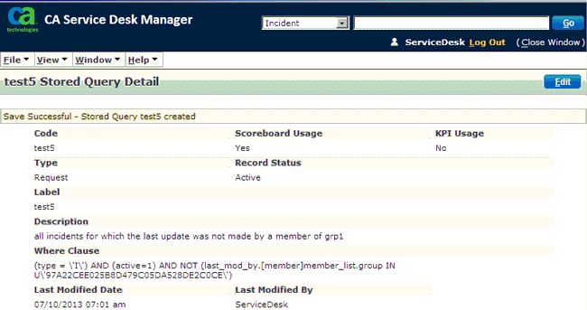

  6. Use the results from step#2 to enter the stored query definition. For example, enter:
    Type
    Request
    Description
    all incidents for which the last update was not made by a member of grp1
    Where Clause
    (type = \'I\') AND (active=1) AND NOT (last_mod_by.[member]member_list.group IN U\'97A22CEE025B8D479C05DA528DE2C0CE\')
    Figure 1: Stored query example
