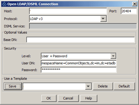

Next step would be to connect to the notification DSA (<HOSTNAME>-impd-notify) using an LDAP browser and remove the problematic notification:
Note:  Please make sure to have a backup of the DSA in place before making any of the following changes!
1.  Connect to the notification DSA - using jxplorer for example:
Host: Provisioning Server hostname
Port: 20404 (Default port used in vApp, change if you changed it)
User DN: eTDSAContainerName=DSAs,eTNamespaceName=CommonObjects,dc=im,dc=etadb
Password: password used during installation.
(You could also lower security temporarily by setting min-auth=none; via DSA Management Console for the DSA)
