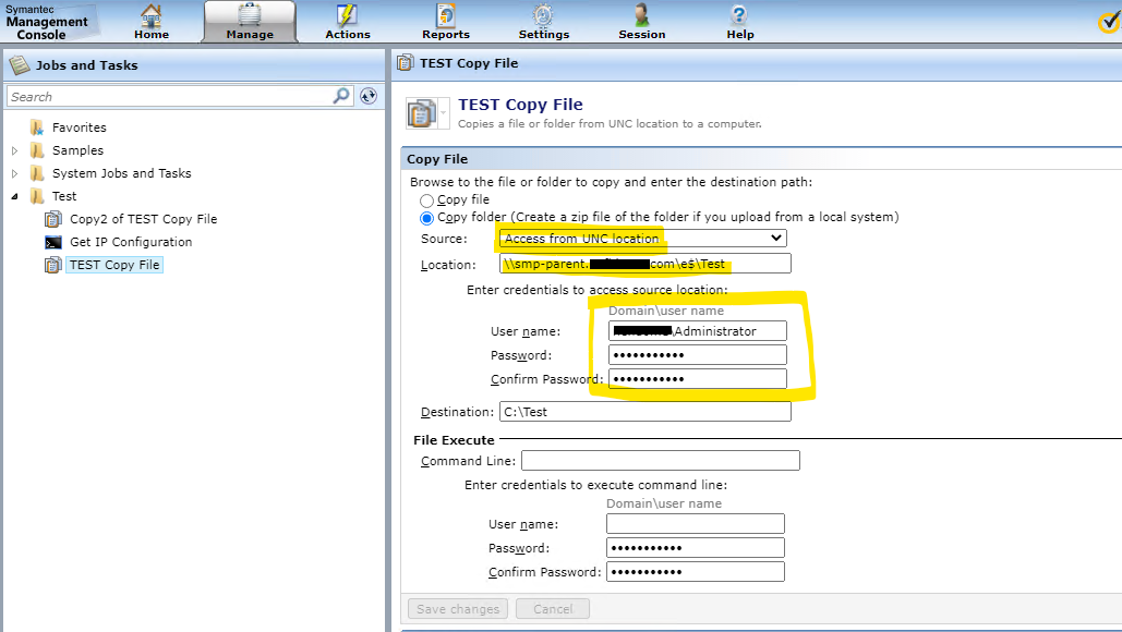

1. If you use "Access from UNC location", and you are not sure if that UNC location is open to "Everyone", then you will need to add credentials to access the files.
This option doesn't create a "package" on the Parent Package Server nor on the Child Package Server. The replicated "CopyFile" task will access back the source directory that you specified on the task and copy the files directly that way and create/update the folder structure that you designated on the destination path for those systems.

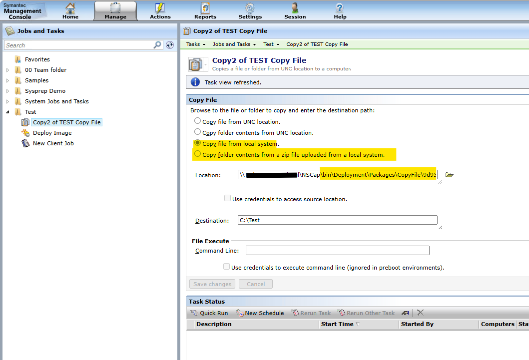

2. If you use the option "Upload from local system", it creates a zip file of the folder on that same source folder, and creates a directory folder under "...\Program Files\Altiris\Notification Server\NSCap\bin\Deployment\Packages\CopyFile\" on the Parent SMP and then unzip the content into that new folder. And you don't need to add credentials here since the download process is done by the package server and client agent.

Then a package is created in the Parent Package Server and to the Child Package Server as well when the "CopyFile" task is replicated.
There is not a copy of the files under "...\Program Files\Altiris\Notification Server\NSCap\bin\Deployment\Packages\CopyFile\" on the Child SMP since the files are handled by the Child package server.
If you were to create a "CopyFile" task on the Child SMP using "Upload from local system" option, then that location will be populated by this process as a regular SMP.
