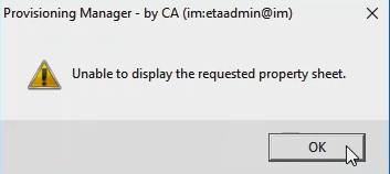

If a UNIX v2 Endpoint IP address is modified without first updating the endpoint configuration in Identity Manager, the Provisioning Manager may lose connectivity. Attempting to open the configuration in this state will result in an "Endpoint read failed" error, preventing further management of the endpoint. This article outlines the manual recovery procedure using a third-party LDAP browser.

The Provisioning component maintains a configuration record of the endpoint, including its host IP address, within the Provisioning Directory. When the underlying endpoint IP address is modified externally without first updating this configuration in Identity Manager, the Java Connector Server (JCS) attempts to communicate with the endpoint using the obsolete, stale IP address. Because this connection fails, the Provisioning Manager UI cannot successfully "read" the endpoint state, causing the management console to lock the property sheet and block further configuration updates.
