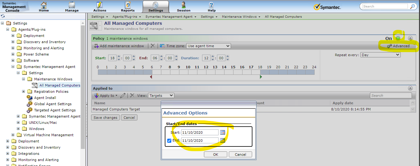

You are trying to implement a couple of maintenance windows on a future schedule. The maintenance windows were configured to start at a later date, but once the maintenance window was enabled, it already enforced and prevented tasks from executing. Your expectation was as it should've only started the enforcement at the date specified.
You have a maintenance window that you want to be enforced/activated (meaning be able to run and do things without restrictions) until a certain date in the future as specified in the "Advanced" option (for example start and end date of Nov 10 2020). They want that the maintenance window is only active/in use/enforced on a specified date (a day or a week).

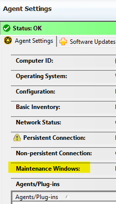

The agent UI shows that the maintenance window "Next activation" is until 2020-11-10:
But when you run a task against one of those machines that are targeted by this maintenance window, it will not run and display a "Non in maintenance window" warning in the task UI.
If you try to set the start and end dates THEN disabled the policy to see if gets enabled at the specified date, but nothing happened either (Note: That's correct, when policy is disabled it is disabled on the server, so client does not even know anything about it.)
It seems like if a maintenance window is active, anything outside of the specified dates are inactive hours regardless. In your case this is a bit problematic since you would prefer having lockout hours enabled only on the dates they need it and the rest of the time all hours are active.

"Advanced" options are applied to the whole policy only, so you will need two policies.
Create one more maintenance windows policy and assign it to the same machines. Set start time to 00:00 and end time to 24:00.
Set the needed start/end dates for both policies.
