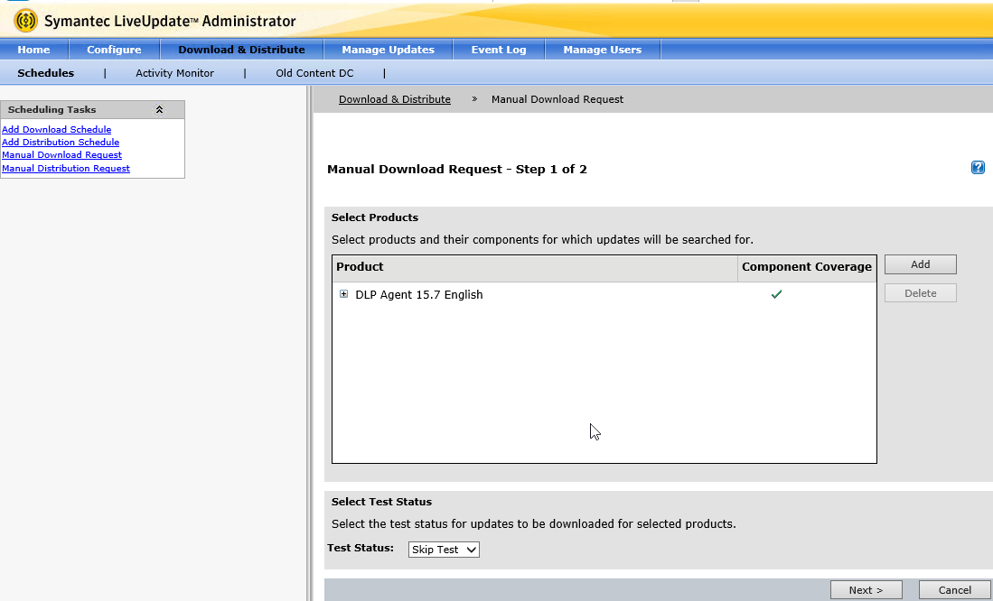

Run a new manual download request
- In the left pane, under Scheduling Tasks, click Manual Download Request.
- In the Manual Download Request - Step 1 of 2 window, select the products you want to add to this request by clicking Add.
- In the Select products to be added window, select the product or products you want to add and then click OK.
- Select the test status for this download request: Skip Test or Must Test.
- Click Next.
- In the Manual Download Request - Step 2 of 2 window, select the updates that you want to download. You can select all products and components, or you can select specific components such as Software Updates or Virus Definitions.
- Click Next to start the download request.
