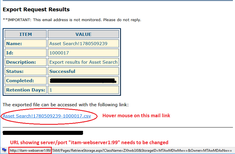

CA IT Asset Manager installation is leveraging the Data Export functionality and the URL in the received email for the Data Export is inaccessible by the end users.
For example, end users need to use a web site alias or apply a FQDN instead of just the ITAM Server name. Port number also needs to be updated as well.

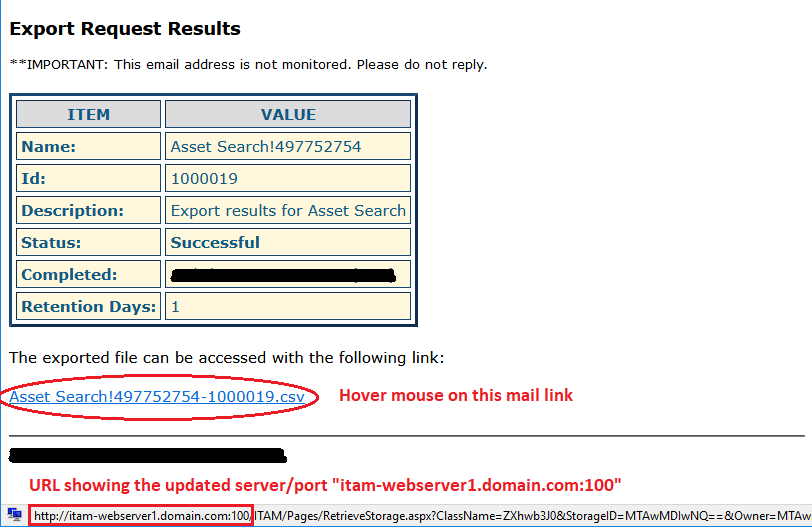

The Data Export mail should present with a new URL based on the changes made above:
This will only affect new exports generated after the above change is applied.  Previous mails generated prior to the above change will retain their old server/port values.
