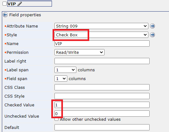

In the Screen configuration of Profile tab of the Modify User task, the %STRING_09% attribute has been defined as checkbox, with Checked Value (value when the checkbox is selected) is set to 1 and Unchecked Value is set to 0.
This issue won't happen if %STRING_09% is defined as Text Style or positioned not as the last column.
To workaround this problem, you can add additional comma (",") at the end of the line after the last space character in the feeder file.
