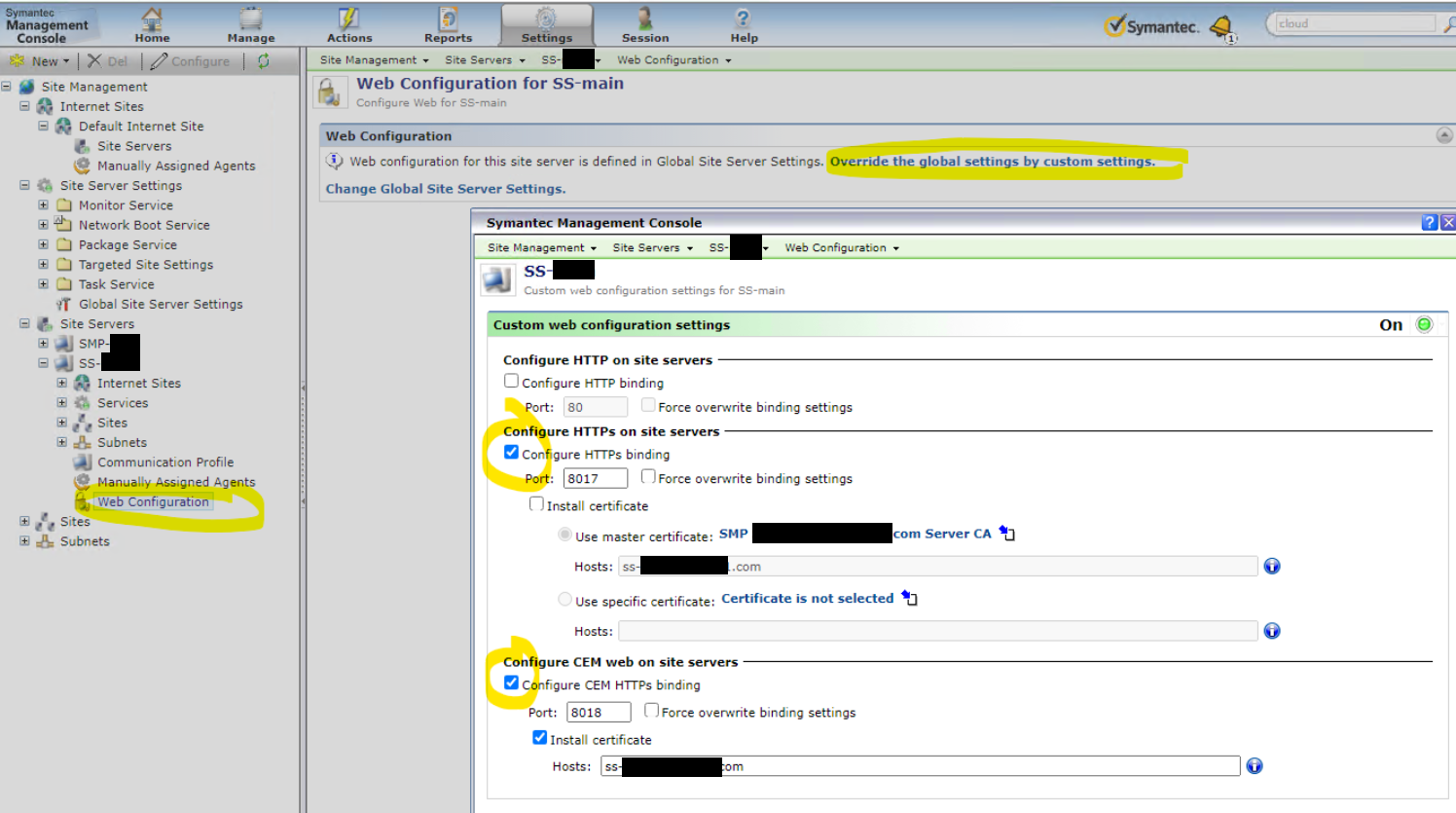

 Problem can be reproduced in this condition:
  • TS uses custom web setting policy
  • Intranet binding is OFF
  • CEM binding is ON
ITMS 8.5 RU4
Known issue. Incorrect port usage by websocket server at site server in case of disabled HTTPS.
The Global Site Server Settings for the internet Site Server used for CEM was disabled and custom setting (Override the global settings by custom settings) were turned ON with "configure HTTPs on site servers" check box turned OFF and "configure CEM web on site servers" check box turned ON with a custom port (instead of the default 4726 port).
A fix for this issue has been added to ITMS 8.6 release.
The current workaround is to have "Configure HTTPs binding" check box turned ON under the "Configure HTTPs on site servers" section for your custom settings for your Internet Site Server.
