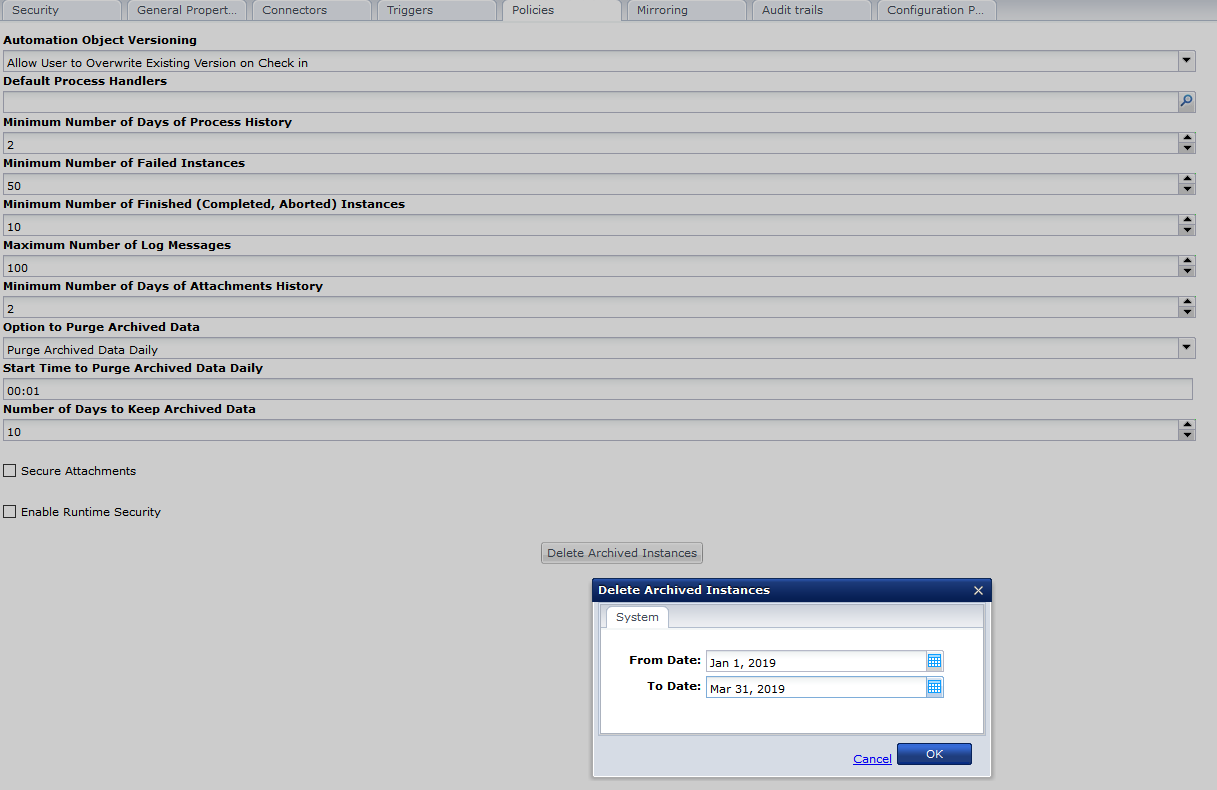

  4. Click on the Policies Tab
  5. Specify values for Minimum Days of Process History, No of Days to Keep Archived Data, and ensure Option to Purge Archive Data is set to Purge Archived Data Daily.
  6. Save the modifications.
  7. Click the Delete Archived Instance button - specify the date range, and purge the Archive to clear all processes that where Archived prior to the upgrade as they will not have any Purge schedule configured.

If your Process Automation engine has been running for without the Archive and Purge configured, you will need to use the Right Click / Archive option from the Operations view to push instances into the Archive:
And then on the Configuration> Orchestrator > Policies Tab, use the Delete Archived Instances button to delete the existing Archived Instances:
It is recommended that you start with 1-3 month blocks to purge as this will impact the database and can impact overall Orchestrator performance.
