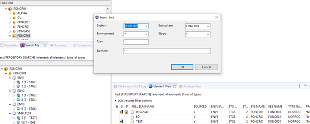

The functionality of the Endevor Eclipse plugin has appeared to have digressed. When displaying a Project that is defined at the lowest Endevor Environment, the Serch Map View used to display then entire map for that System up to the PROD environment. This allowed for Browsing and Retrieving an element from a higher level down to Local or add to the Project level.  Now the only environment that is displayed is the environment that is defined to the Project.
How to view the entire map for that system in the search map view using UI plugin 18.1.6 ?

Click the 'search selected repository' icon in the repository view
In the search box, enter the system and subsystem information, then leave wild card for all the other search criteria. The search map view now display entire map in the system.
