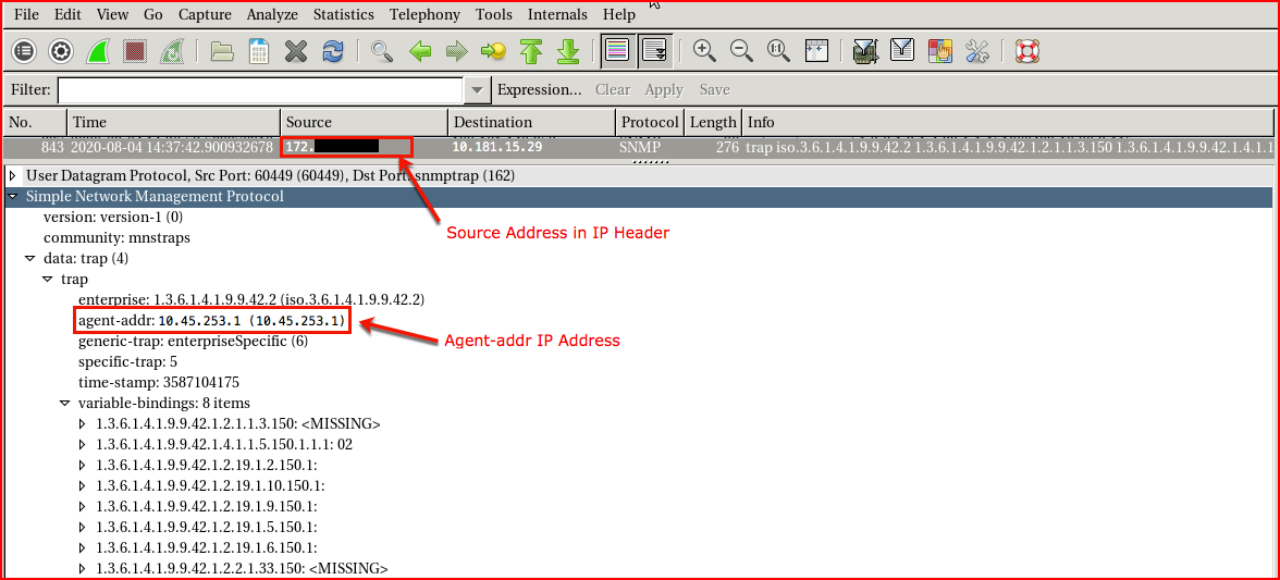

In Spectrum 10.2.2 the SpectroSERVER was processing traps for some devices using the address in the IP Header instead of the address
  inside of the agent-addr field of a v1 Trap. After upgrading to Spectrum 10.4.x this is no longer the case, the SpectroSERVER is only looking
  at the agent-addr address.
Scenario: A Cisco 9000 series device was discovered and modeled within Spectrum. The device was discovered using a NAT'd address and
   the IP Address assigned to the management interface (mgmt0) was not picked up by Spectrum due to the address not being listed
   in the ipAdEndAddr table. In Spectrum 10.2.2 the SpectroSERVER was processing the traps even though the management interface address
   being sent in the agent-addr field did not exist in Spectrum. In 10.4.x the trap is not processed and a 0x10802 trap from an unknown device
   event is generated on the VNM model.

The SpectroSERVER has a feature option that allows it to process traps using the IP Address in the IP Header for RMON enabled devices. In
  Spectrum 10.2.2 this feature was being defaulted to on and therefore the SpectroSERVER was able to process the trap even though the
  management agent IP address did not exist in the SSdb. In Spectrum 10.2.3+ this seems to have been fix and the feature defaults to off BUT
  another bug is present in that the SpectroSERVER does not read/check for the existence of the setting in the .vnmrc properly
