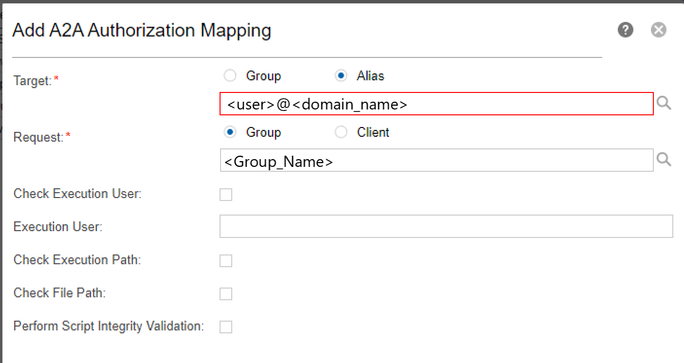

In PAM UI  (Credentials / Manage A2A / Mappings) add a new A2A Authorization Mapping for the A2A Target Alias.
For now allow all Requestors, do not put any filter options for the script/app execution

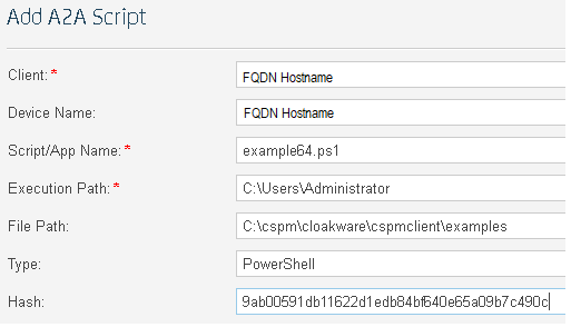

View the A2A log file C:\cspm\cloakware\cspmclient\log\cspm_client_log.txt and retrieve the values for Script name, Script location and Script hash
Target alias: <user@FQDN>
Script name: example64.ps1
Script path:
Script Location: C:\cspm\cloackware\cspmclient\examples
Script hash: The hash value, this changes based on the script
In PAM UI  (Credentials / Manage A2A / Scripts) add a new A2A Script definition.
Enter the values for Script/App name (the actual script/app name as output in the log), Execution Path (the location from which this script is allowed to be run), File Path (the full path to this script/app), Type and Hash (as output in the log) accordingly.
Update the Authorization Mapping and limit the execution of the Script/App as per your needs.
Request (The A2A client allowed to call the script/app)
Script (All or Individual scripts/apps are allowed to run on this client)
Execution User (the logged on user who is allowed to execute the script/app)
Check Execution Path (script/app can only be from in the specified directory)
Check File Path (script/app must be located in the specified directory)
Perform Script Integrity Validation (script/app must not be modified, i.e. its hash is unchanged)
Attempt to rerun the script while violating any of the above policies (in this example the script was modified) and observe retrieval of the target account credentials are refused accordingly.
